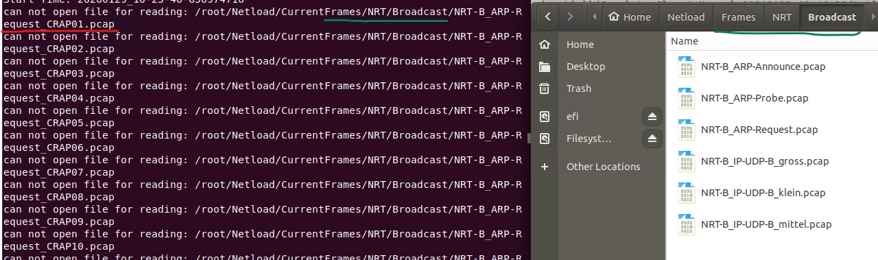

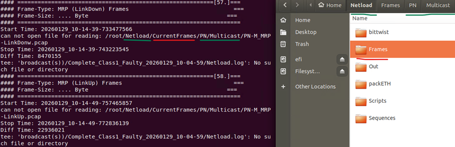

I'm attempting to run the Netload Robustness tests for "PN Controller: a 1 port RT", option 4. Both the faulty and normal communication. When running it seems like the .deb package install didn't create all of the pcap files and the path is incorrect.
The file path in the terminal is: /root/Netload/CurrentFrames/...
But not CurrentFrames exists, only Frames.
There are also files that don't exist (Just one example):

The "CurrentFrames" folder is only created during the actual test setup, as the contained PCAP files are adapted to the MAC address of the PC and the device under test (DUT).
For further information, please refer to section 2 in the document "How to install and run the security level 1 tester V2.43.0.0_V1.0".
It is important that you use a name without "blank" in steps 6 and 7.
For example, "Device Type" is not allowed, but "Device_Type" is.
