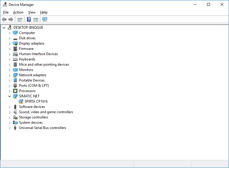

However, when I restart the PC with this setting, a warning "!" appears on the device in SPIRTA in Windows Device Manager (attached file: DeviceManager.jpg).
The warning disappears when I reset the "Another way is to enable test-signing boot configuration." setting, but the warning "!" appears again when I restart the PC again.

Dear Raik,
Thank you for your reply.
Regarding questions 1 and 2, I understand that there is no need to specify an IP address, as it will be automatically set to a unique address specified by SPIRTA.
The problem is question 3.
The PC we procured for authentication is a SIEMENS SIMATIC IPC847E.
The selected OS edition is "Windows 10 Enterprise 2016 LTSB, (En, Ger, Fr, It, Sp), 64-bit (for Core i7, Xeon)."
OS options for the SIEMENS SIMATIC IPC847E are limited to the following:
1. Windows 10 Enterprise 2016 LTSB, 64-bit (for Core i3, Core i5)
2. Windows 10 Enterprise 2016 LTSB, 64-bit (for Core i7, Xeon)
3. Windows 10 IoT Enterprise 2019 LTSC, 64-bit (for Core i3, Core i5)
4. Windows 10 IoT Enterprise 2019 LTSC, 64-bit (for Core i7, Xeon)
5. Windows 10 IoT Enterprise 2021 LTSC, 64-bit (for Core i3, Core i5)
6. Windows 10 IoT Enterprise 2021 LTSC, 64-bit (for Core i7, Xeon)
7. Windows Server 2016 Standard Edition 64-bit, 5 clients
8. Windows Server 2019 Standard Edition 64-bit, 5 clients
9. Windows Server 2022 Standard Edition 64-bit, 5 clients
So, I'd like to somehow run this on my current Enterprise OS. Is there a way to work around this issue?
Currently, when I run "install.bat" at the end of the setup, the warning mark "!" for the CP1616 card displayed in Windows Device Manager disappears.
Also, if I run the SPIRTA test as is, the test seems to run successfully.
However, when I power the PC back on, the warning mark "!" for the CP1616 reappears.
Running "install.bat" again clears the warning mark "!" for the CP1616.
In other words, I have to run "install.bat" every time I power it on.
It's a bit inconvenient, but is this the only option?
Thank you in advance.
