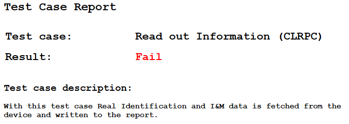

Hello,
Just upgraded my ETS system to the latest version, V2.46. Noticed there's a new test case, called "Read out Information (CLRPC)".
To validate the installation, run it with my dut previously approved by 2.45. All test cases were cleared, except this new one.
Based on the description, something related to the I&M data is not quite right. I didn't find further information in the installation directory "2025_08_21_PN-Test-V246/". Besides, PRONETA shows the I&M data that I support just fine.
So the question is, what exactly does this test do?
Best Regards,
Luciano.

Hello Luciano,
this test case was added on a customer wish to the test system. It reads out useful information of the attached DUT.
This test case is not required for any official certification. In case something is not correct with your I&M Data, other test cases like TCS_00000020_IP_UDP_RPC_I&M_EPM would highlight this.
Best regards,
Raik

Thank you Raik! Not going to bother about it anymore.
Best Regards,
Luciano.
