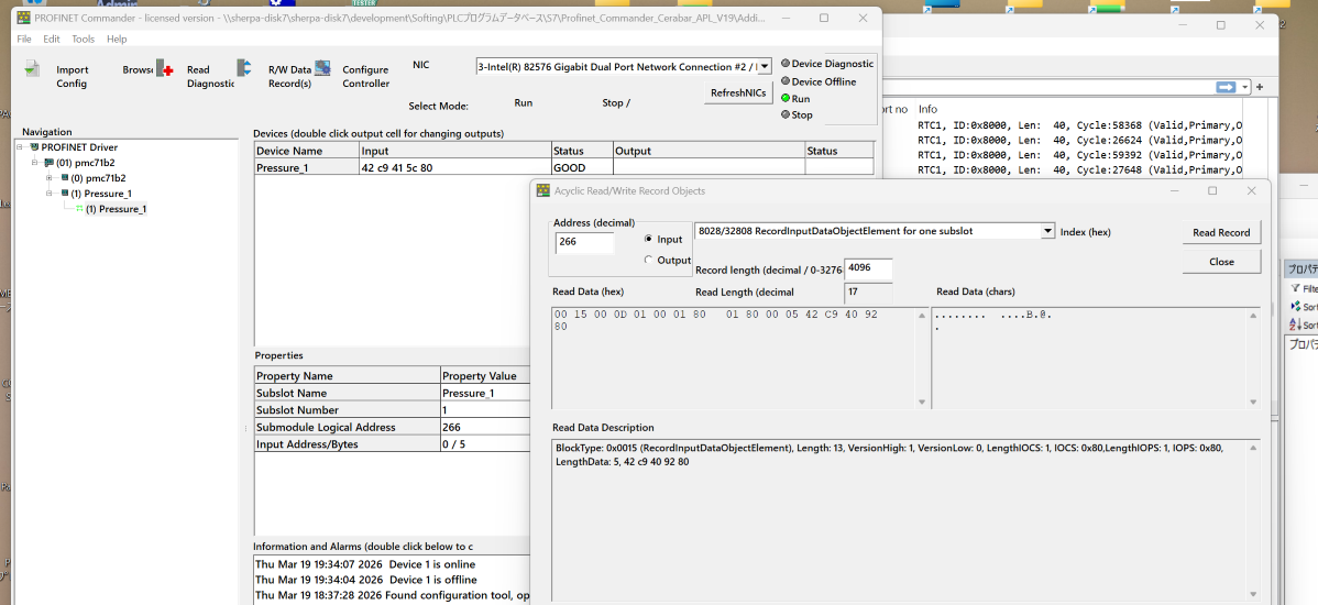

Benja_m:
Thanks so much. If I use Profinet Commander communicating cyclically, I am able to access the RecordInputDataObjectElement acyclically from the Profinet Commander.
But if I setup an S7-1200, without configuring the the Cerabar as a Profinet IO, the Cerabar ignores the acyclic requests from the S7-1200. I wonder whether by S7-1200 program is wrong. Below is the Profinet Commander and the S7-1200 program. The S7-1200 is taken without the Profinet Commander running.

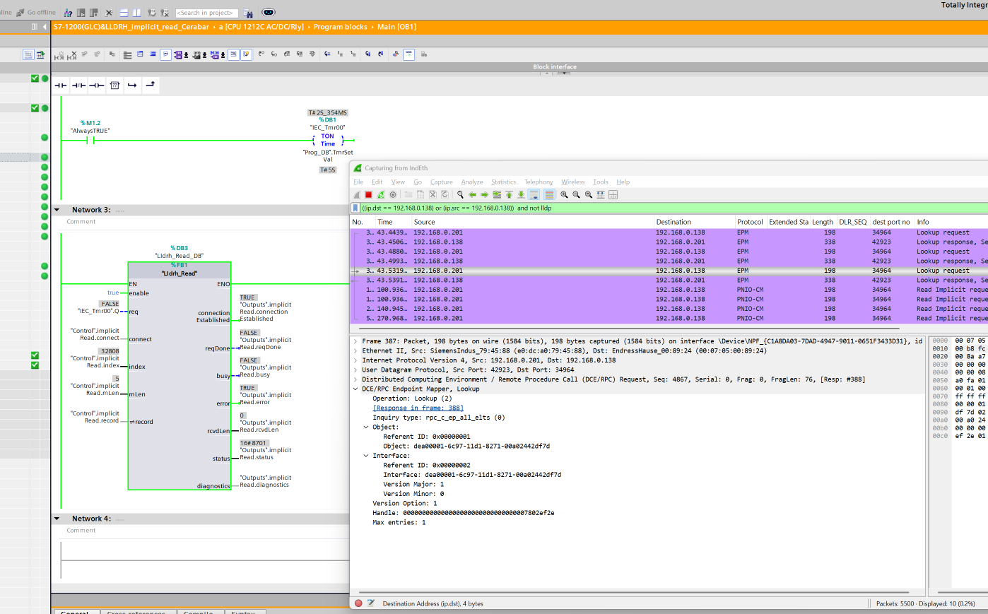

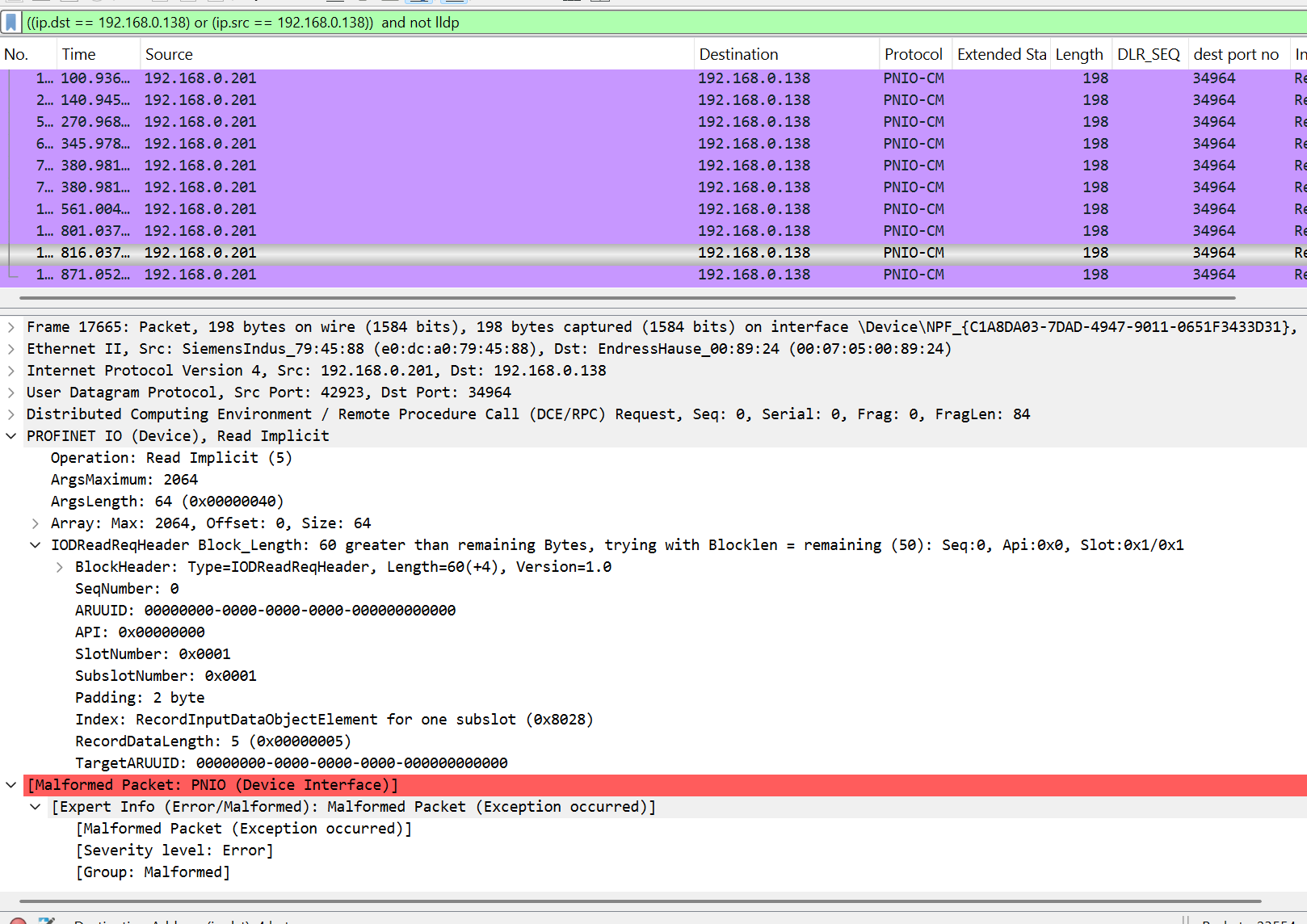

It seems the request is too shorts. The IODReadReqHeader should contain 8 padding bytes after the TargetARUUID which seem to be missing in screenshot. That could be cause for completely missing reaction of the device.

Benja_m, hello again. I was not able to work on this issue in the last week or so, until today. I think I have fixed my S7-1200 program and now the request is being sent correctly (I think), as there is no malformed warning from the Wireshark add-in for PROFINET. And also because now there is a response from the field device.
Unfortunately it seems the field device does not support the "implict read" request. Can you please have a look and the Wireshark trace so you may confirm that the request is being sent correctly? If that is the case, I will contact the representative of the manufacturer here in Japan.

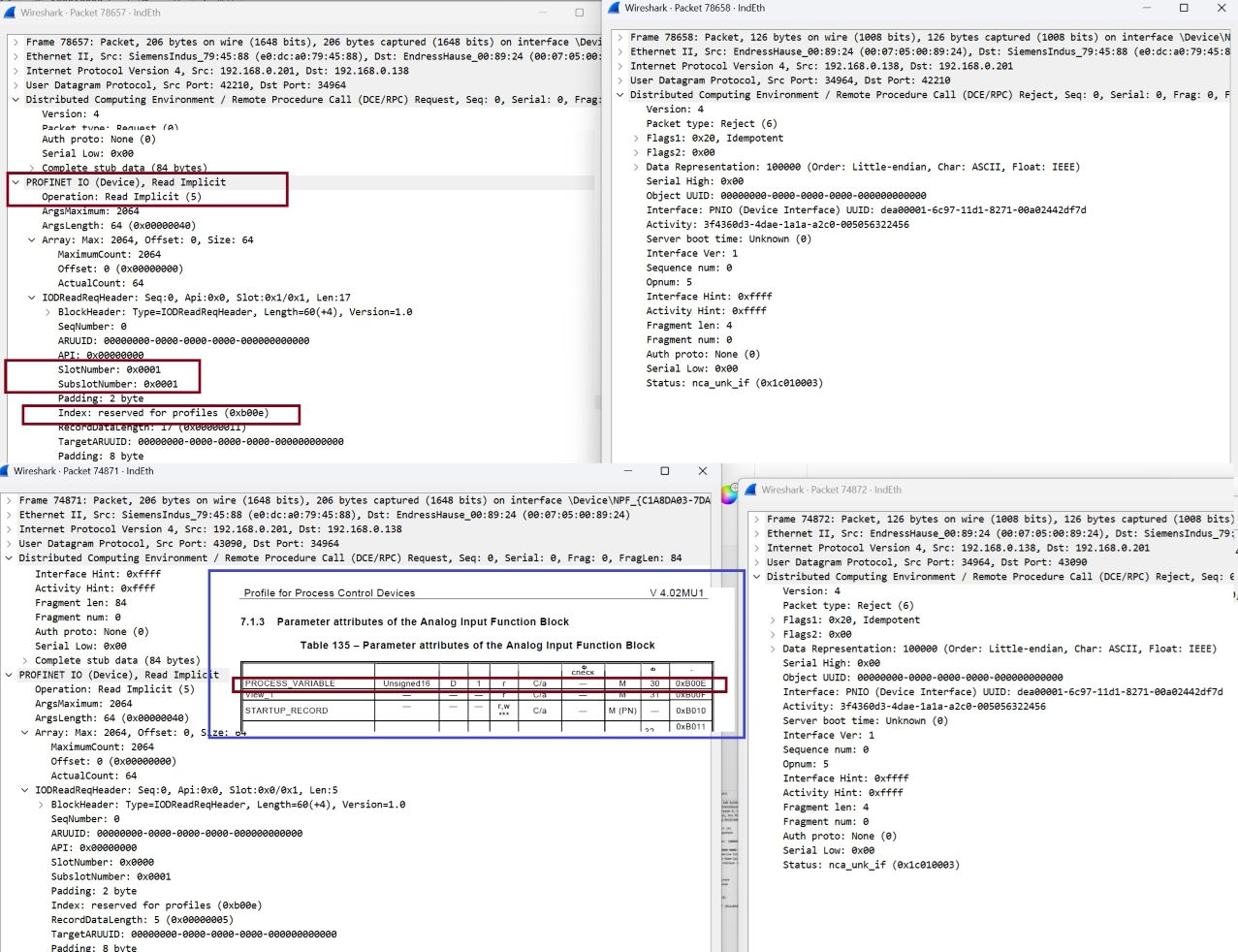

I have also tried to access index 0xB00E, "PROCESS VARIABLE" parameter for Analog Input Block as per PA profile which is mandatory according to this standard. Tried slot/subslot 1/1 and 0/1, but in all cases I get nca_unk_if. I wonder whether I am doing something incorrectly or whether this device conforms to the PA Profile. Thanks for your advice.

Hello Benja_m:
I realize how clueless I am. The target_ARUUDI are set to zero. I need to fund out how to correctly set this parameters.

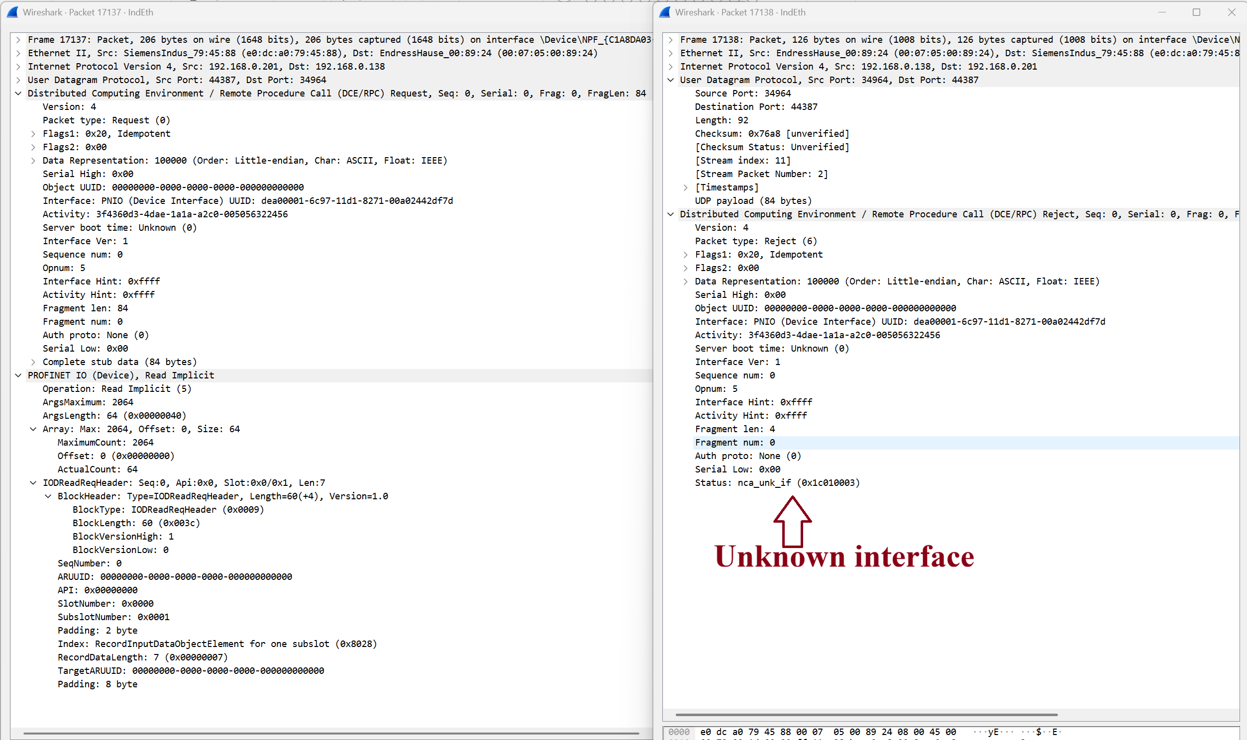

Unknown interface means that the ObjectUUID inside the DCE/RPC part of the request is unknown to the RPC layer of the device.
According to your screenshot, the ObjectUUID consists of only 0s which is obviously incorrect.
This error message is not related to the TargetARUUID, which is a different UUID used for other purposes in a different communication layer.
