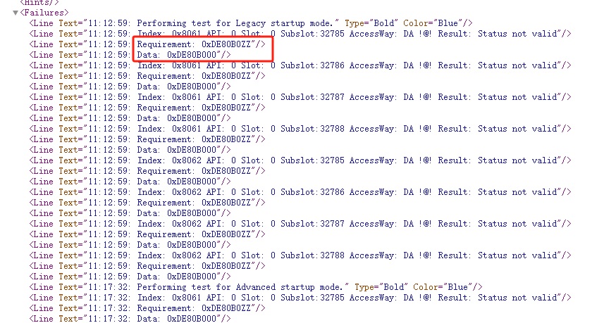

Hello PROFINET Forum experts.
I tested our device with ART(2.44.1.2). The device has 16 electrical ports and 4 optical ports.
I meet a strange problem when testing Different Access Ways Port2Port (CLRPC).
The failure information of the case is shown in the attachment.
The reason for the failure it prompted confused me.
According to my understanding, the content carried in the message should meet the requirements of the test case.
Please help to analyze, Thanks a lot.

Does your device support PowerBudgetControlSupported and FiberOpticTypes in your GSDML?
I would suspect that also Different Access Ways is failing.
Is it possible that you send the project (project-file, gsdml, report, pcaps, grpc-logs) to [email protected]?

Hello, s.zach:
Thank you for your reply.
I have already sent the email, please check it.
If you need any other information, please let me know at any time.
