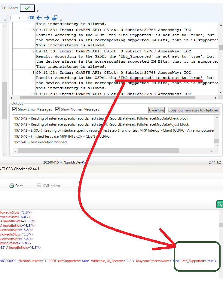

This is strange. With ART 2.44.1 we are testing our solution which now supports I&M5 (the previous version didn't so this is the first time I see this.).
The ART is telling me that the GSDML file does not enable IM5_Supported="true". However this is not correct. Our GSDML file has the IM5_Supported="true" entry.
However, the different access ways test case fails with the error:
"According to the GSDML the 'IM5_Supported' is not set to 'true', but
the device states in its corresponding supported IM Bits, that it is supported.
This inconsistency is allowed."

Parts of this was fixed in the meantime. Please check with last available Innovation bundle.

Thanks so much. With this newer 2.44.3 version we do not see this problem.

I'm having this exactly same problem when testing my device, but with the latest ART, version 2.45.0.2.
Could it be a regression in test bundle? Does anybody experienced similar issue?

Yes, i see the same issue (message "According to the GSDML the 'IM5_Supported' is not set to 'true', but the device states in its corresponding supported IM Bits, that it is supported. This inconsistency is allowed") here. But it does not lead to "fail" in our case. Test is "passed with hint".

Yes, same here with ours, "passed with hint". Needed to be sure though.
