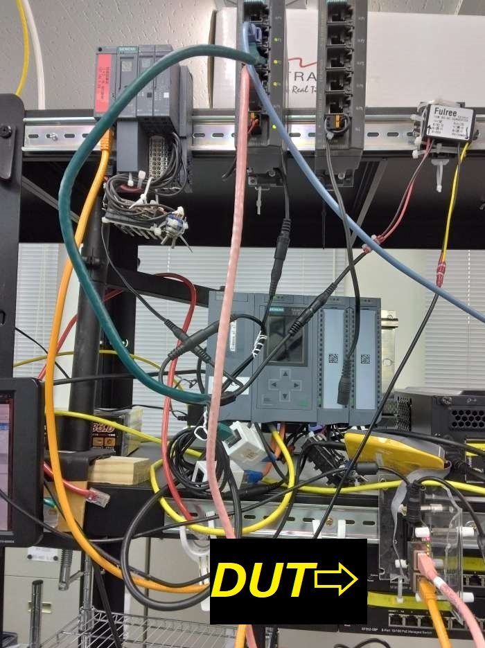

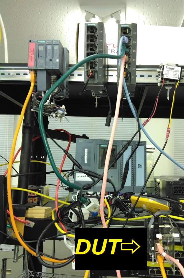

One of the switches works as expected. But the other does not work as expected. I explain myself: The standard setup for netload shoes the S7-1500 (device 'a') communicating normally with DUT and device 'c' (the ET-200). But this one switch does not capture LLDP packets, hence the test fails with this switch but passes with the other one.
For the switch that lets LLDP packets get to the capture, the LEDs in the switch are orange, whereas in the other the LEDs are green.

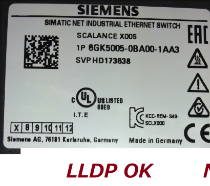

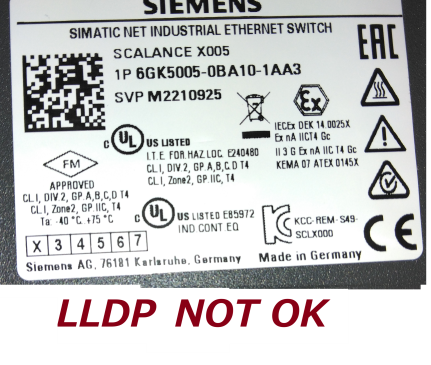

to my knowledge there are two different versions of the switch out there one forwarding LLDP frames and one IEEE compliant version that does not forward the LLDP frames.
The test spec request the E7 (an kind of revision of the switch) which is the older, LLDP forwarding one. Unfortunately, I'm unable to read the label on your picture. Could you please try to upload a better image of the labels only.

BR, thanks very much for these words of wisdom. Sorry for poor picture quality. Did not notice the revision version of the spec. I guess that is the problem of using eBay. Here is a new picture with better resolution.

According to the test specification only the X005 switch with the order number 6GK5005-0BA00-1AA3 and only in the specific version E7 can be used for the testing. The switch with the order number 6GK5005-0BA10-1AA3 as mentioned by llindemann before is an updated version of the switch which behaves IEEE compliant and drops BPDU (Port To Port protocol) frames like LLDP, PTCP, ...
