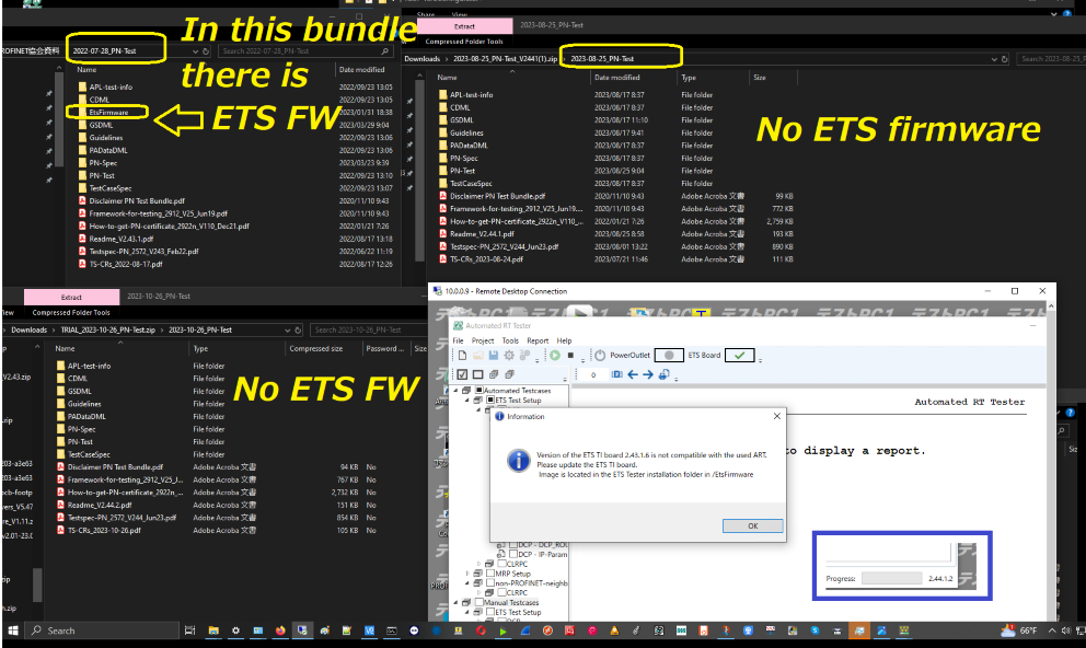

Hi. I cannot find the new firmware for the ETS board in the test bundles provided on the PI site.
I cannot execute the ART, as a result.
Is it possible that the test bundles were updated without the ETS firmware?

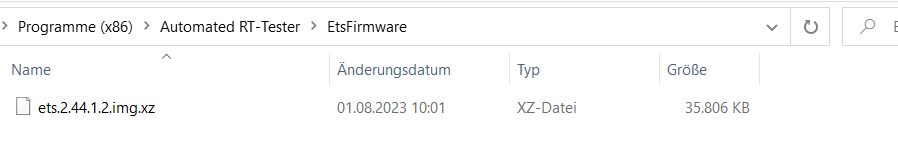

Install the Automated RT Tester and within the installation directory of the Automated RT-Tester (default: "C:\Program Files (x86)\Automated RT-Tester") you find the EtsFirmware folder which contains the fitting EtsFirmware for this version. It was always there and the duplication in the bundle itself was removed. This is also part of the corresponding documentation.
