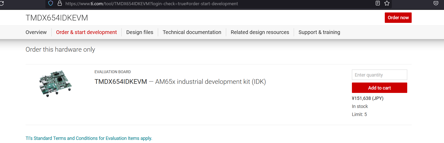

Hello. I just checked in the TI Online store and it seems there is inventory available.
https://www.ti.com/tool/ja-jp/TMDX654IDKEVM

first, I don't understand what's wrong with the stock.Cause I used to consult with TI's FAE,they told me they could find some stocks online, just the same as you.But when to place an order, something wrong occurred.... :o :o
