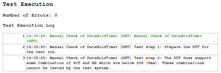

Hello,
Of all tests performed, only one is reporting 'Inconclusive', Manual-DHT.
Screenshot 2025-05-15 160547.png (31.49 KiB) Viewed 44087 times
Screenshot 2025-05-15 155522.png (31.76 KiB) Viewed 44087 times
As a result, Certification Report shows one error. According to TCS_00000014_DHT document, page 11, "... a manual investigation shall ensure the consistency of the responses".
Question, is it ok to submit the product for certification this way? I mean, is it something critical that I have to check right now (TBH, don't really know how) or am I overthinking?
Thanks,
Luciano.

Hi,
the faster cycle times have to be tested using the IOC Controller "A" and manual investigation of the wireshark traces.
Best regards,
Raik
