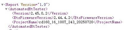

Our equipment is undergoing certification testing. The test results from the certification laboratory using the same version of the test suite are inconsistent with my own test results. The Test tool version information: ART(2.45.0.2), ETS(2.44.4.2).
In the certification laboratory testing, four test cases failed. But When I retested these cases using ART, they passed. These differences leave me confused.

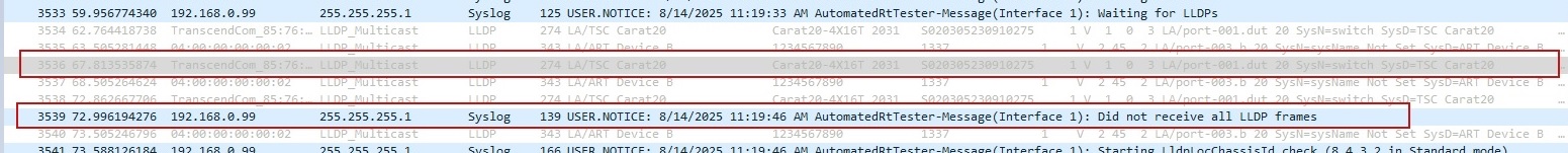

It indicates that LLDP frames have not been received, as shown in the following figure.
But I can saw LLDP messages sent by my devices in the packet capture files.

Analyzing the logs of TEDCheck (CLRPC) returned by the certification laboratory.

I do not know if this is cause for the issue, but your device misbehaves regarding usage of MAC Addresses.
In network capture files provided, all three ports use the same MAC Address, which is even identical to the Chassis MAC Address. Maybe this causes the tool to create this error message.
Expected behavior: Each port uses it's own Port MAC Address which shall be different to the actual Chassis MAC Address.

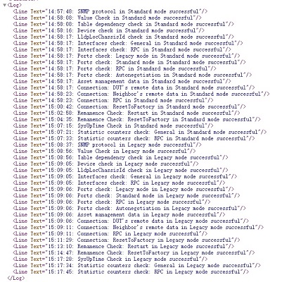

There is another situation, in my own testing using ART and ETS, this test case passed.
My own test results are inconsistent with those of the certification laboratory, and this difference is quite strange.
Comparing two test logs, I cannot find the reason for the failure.
Could you please help me check if there are any abnormalities in my logs?
The attachment Self_Test_TEDCheck (CLRPC).7z is my testing logs.
