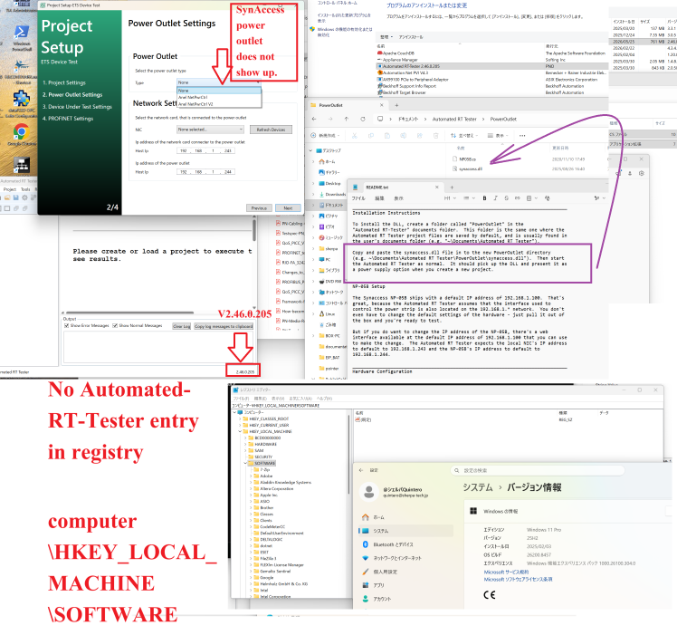

Hello:
I am trying to setup an ETS project that uses SynAccess power outlet, but the ART would not let me do this.
I have tried to follow the instruction in the documentation.
Reading other posts and checking the documentation I realize there is no registry entry in Computer\HKEY_LOCAL_MACHINE\SOFTWARE.
What am doing wrong?
brent

Hi Brent, thanks for your answer.
I guess you did not have the time to look at my screenshot which explains that I indeed followed the procedure in the test specification, and yet I am unable to select SynAccess as the power outltet for the test.
Will be grateful for more specific advice. Before I come to the forum I exhaust all possibilities, and I try to go through the formal documentation. For this one post I think I did, but I may have done something incorrectly.
Thanks for reading and commenting.

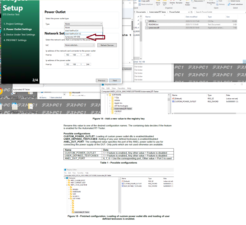

Hello again:
I cracked the issue thanks to the Japanese PI Laboratory. In addition to adding the required files in the "...Documents\Automated RT Tester\PowerOutlet" folder, there is one Windows registry modification which is now necessary, as documented in the "ProductDocumentation-1.pdf". Now I can select the SynAccess power outlet.
