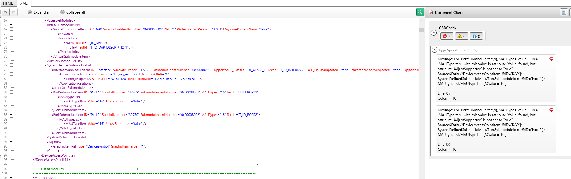

The GSDML file for the product we are developing is failing the check performed by the PROFINET GSD Editor V2.46. Checker complains about the attribute "AdjustSupported" when set to false (lines 85 and 90).

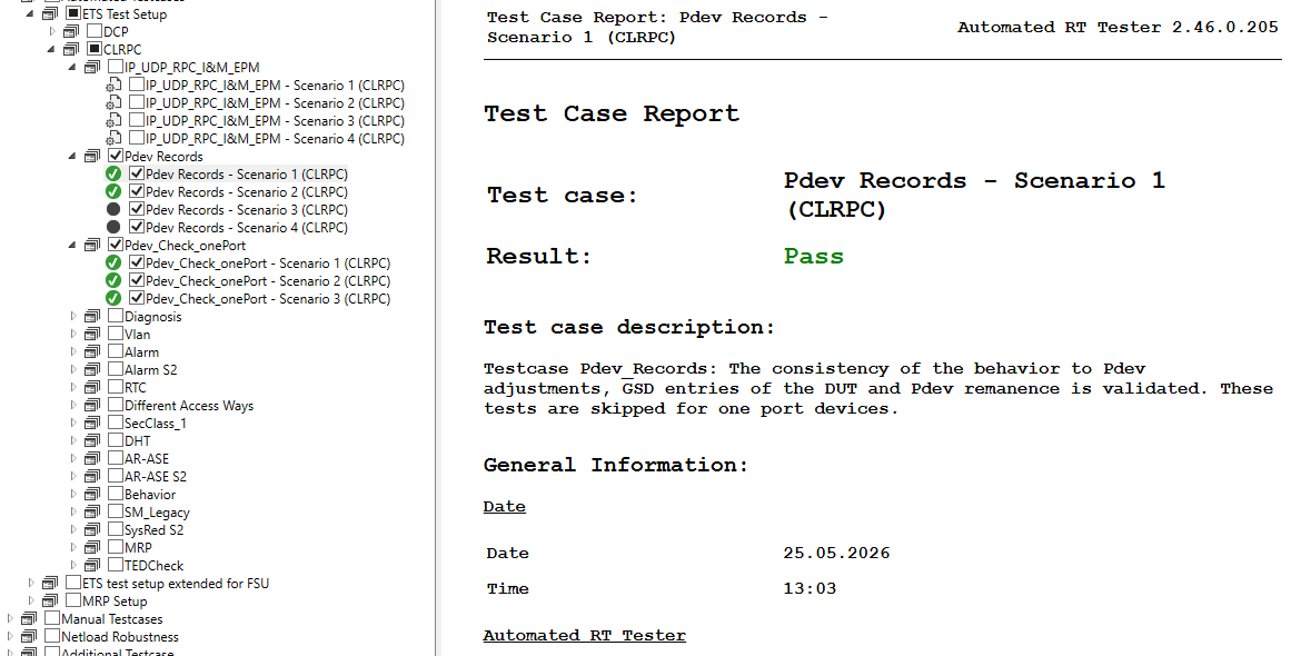

However, even with this issue in the GSDML, the relevant test run by the ART is successful.

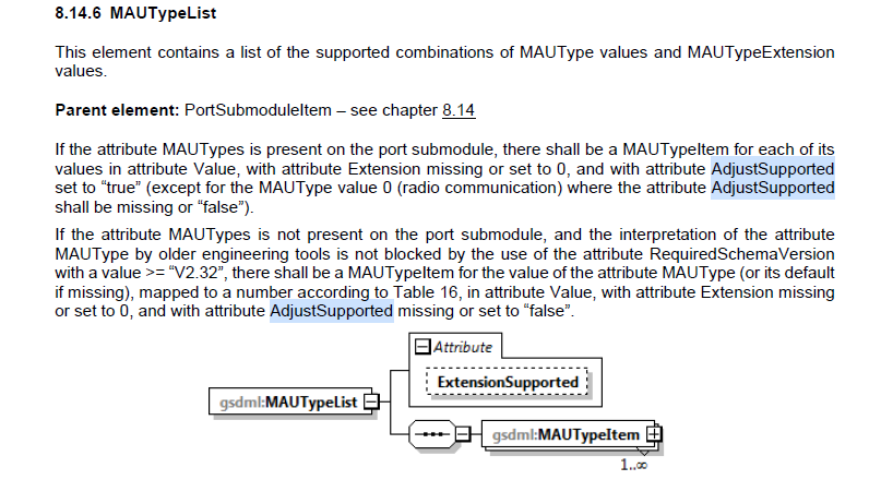

We understand, by looking at the spec, this attribute "AdjustSupported" can be set to false. If so, we're wondering why the GSD checker is returning an error at it.

as you are using the superseded attribute "MAUTypes", you highlight that the sub block AdjustMAUType is supported by your port submodule. Removing this attribute and using only the MAUTypeList should solve the issue.

You've nailed it! Simply removing "MAUTypes = 16" from both <PortSubmoduleItem> elements fixed this issue. Now GSDML checker and the ART are returning success for all relevant tests.
